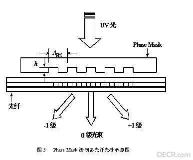

如图所示。相位掩模板(Phase Mask)是衍射光学元件,用以将入射光束一分为二+1级和-1级衍射光束,它们的光功率电平相等,两束激光相干涉并形成明暗相间条纹,在相应的光强作用下纤芯折射率受到调制。相位掩模板是一个在石英衬底上刻制的相位光栅,它可以用全息曝光或电子束蚀刻结合反应离子束蚀刻技术制作。它具有抑制零级,增强一级衍射的功能。Bragg光栅写入周期为掩模周期LPM一半的。这种成栅方法不依赖于入射光波长,只与相位掩模的周期有关。因此,对光源的相干性要求不高,简化了光纤光栅的制造系统,其主要缺点是不同Bragg波长要求不同的相位掩模板,并且,相位掩模板的价钱较贵。用低相干光源和相位掩模板来制作光纤光栅的这种方法非常重要,并且相位掩模与扫描曝光技术相结合还可以实现光栅耦合截面的控制,来制作特殊结构的光栅。该方法大大简化了光纤光栅的制作过程,是目前写入光栅常用的一种方法。

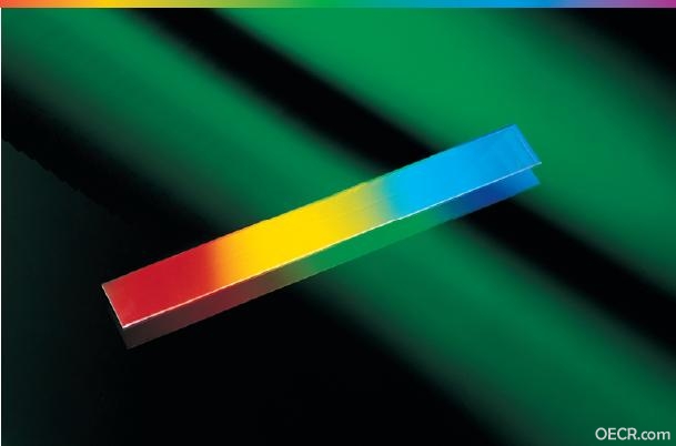

(1)长方形相位掩模板
参数:
Specifications
Operating wavelength 190 - 400 nm
Phase mask period 0.4 - 1.2 μm
Period manufacturing ±0.3 nm for unchirped masks
tolerance (±0.1 nm optional)
Period measurement accuracy ± 0.02 nm
Dimensions Substrate size / Aperture
17.2 x 24.5 mm / 10 x 20 mm
17.2 x 38.1 mm / 10 x 34 mm
17.2 x 50.8 mm / 10 x 45 mm
Custom sizes optional
Chirp range (for chirped masks)0.03 nm/cm - 40 nm/cm
Damage threshold Better than 1 J/cm2 per pulse at 50 Hz @ 248 nm
Diffraction £ 3 % in 0th order; 33 % in ± 1st order
efficiency £ 1.0 % in 0th order; 35 % in ± 1st order
(optional) for periods between 0.66 and 1.2mm
Material Corning 7980, Suprasil
Substrate flatness l @ 248 nm, both sides
Scratch and dig 20 - 10
AR coating Optional
Wedge < 30 arcsec
Thickness 3.175 mm ± 0.125 mm
For chirped masks: center period precision: ± 0.5 nm with ± 200 μm center positioning error.

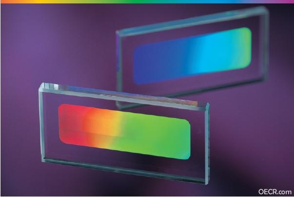

(2)长相位掩模板
参数:
Specifications
Phase mask period 0.6 - 1.2 μm
Period manufacturing tolerance ±0.3 nm for unchirped masks (±0.1 nm optional)
17.2 x 127.0 mm / 10 x 120 mm
17.2 x 152.4 mm / 10 x 140 mm
Chirp range (for chirped masks) 0.03 nm/cm - 30 nm/cm
Diffraction efficiency &pound; 5 % in 0th order; 30 % in ± 1st order
AR coating Optional
Wedge < 30 arcsec
