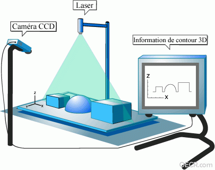

结构光就是把一个具有一定样式的光(面状、网状、或者其它复杂的形式)按照已知的角度照射到一个物体上。这种技术对于图像采集并获取
空间信息是十分有用的。最常用的光源样式就是把一个激光束扩散成一条直线,当这条激光线被投射到一个物体上时,我们会在该物体的表面
看到一条明亮的激光线。通过在一定的角度观察这条线,我们所获得的激光线的扭曲图像可以被转化为该物体的高度起伏信息。

Structured light is the projection of a light pattern (plane, grid, or more complex shape) at a known angle onto an object. This technique can be very useful for imaging and acquiring dimensional information. The most often used light pattern is generated by fanning out a light beam into a sheet-of-light. When a sheet-of-light intersects with an object, a bright line of light can be seen on the surface of the object. By viewing this line of light from an angle, the observed distortions in the line can be translated into height variations.
Acquiring 2-dimensional information Scanning the object with the light constructs 3-D information about the shape of the object. This is the basic principle behind depth perception for machines, or 3D machine vision. In this case, structured lighting is sometimes described as active triangulation.
