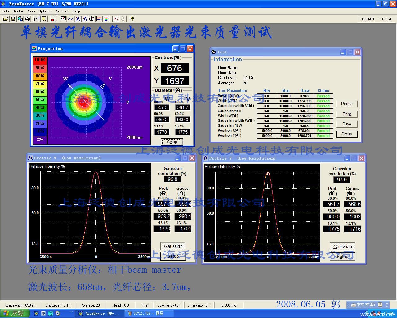

hi there
what method do you use? slit or camera?

原帖由 Victorzhao 于 2008-6-6 18:15 发表
CCD camera/Coherent Beam Master

回复 #3 天天好心情 的帖子
The coupling efficiency is from 50% to 80% in accordance with different types of laser diodes.

原帖由 cosinezheng 于 2008-6-9 21:16 发表
功率如何?最大能有多大?
我们现在做的比较多的有两种:
658nm 单模光纤输出70mW左右
639nm单模光纤输出12mW左右

fiber type
what model of fiber do you use? who is the vendor?
2008-6-14 21:25:54
原帖由 Victorzhao 于 2008-6-10 18:47 发表
The vendor is Fibertech from Germany, we also are the distributor for their fiber products in China.
This type of single mode fiber is with 3.7um corediameter and 0.12NA, thanks for your attention.
