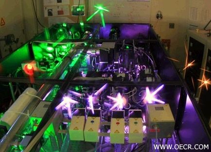

ANN ARBOR, Mich., Feb. 15, 2008 -- Thanks to an additional amplifier, a laser at the University of Michigan can now produce a concentrated beam of light so intense it is like holding a giant magnifying glass in space and focusing all the sunlight shining toward Earth onto one grain of sand.
“That’s the instantaneous intensity we can produce,” with the Hercules (high-energy repetitive CUOS laser system) titanium:sapphire laser, said Karl Krushelnick, a physics and engineering professor at the University of Michigan (U-M) and associate director of its Center for Ultrafast Optical Science (CUOS). “I don’t know of another place in the universe that would have this intensity of light. We believe this is a record.”
The pulsed laser beam cannot be seen by the naked eye, as it lasts just 30 femtoseconds. It takes the human eye one-thirtieth of a second to react to light; a femtosecond is a millionth of a billionth of a second.
The new amplifier of the Hercules laser fires. The laser is now capable of producing a beam so intense University of Michigan scientists believe it sets a record. (Photo courtesy Anatoly Maksimchuk, associate research scientist, U-M Department of Electrical Engineering and Computer Science)

Hercules takes up several rooms at CUOS. Light fed into it bounces like a pinball off a series of mirrors and other optical elements. It gets stretched, energized, squeezed and focused along the way.
Hercules uses the technique of chirped pulse amplification developed by U-M engineering professor emeritus Gerard Mourou in the 1980s. Chirped pulse amplification relies on grooved surfaces called diffraction gratings to stretch a very short duration laser pulse so that it lasts 50,000 times longer. This stretched pulse can then be amplified to much higher energy without damaging the optics in its path. After the beam is amplified to a higher energy by passing through titanium:sapphire crystals, an optical compressor reverses the stretching, squeezing the laser pulse until it’s close to its original duration. The beam is then focused to ultrahigh intensity.
