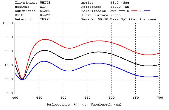

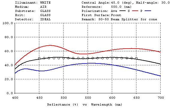

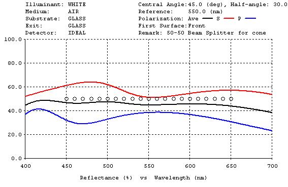

看到一个实例
film stack为(HL)^3
我怎么设计不出来
请高手指点一下
“50-50 Beam Splitter for cone
We are interested in only the average polarization.
Started with the design: Glass | H L H L H L | Air
Used global optimization to find this design.
A number of promising designs were found, but this one
has nice layer thicknesses and low layer sensitivity.”

 楼主| 发表于 2007-4-21 06:24:00 | 显示全部楼层
忽然之间明白了一点点,呵呵
哪位高手能讲明白一点,讲讲设计思路以及技巧,不胜感激!
