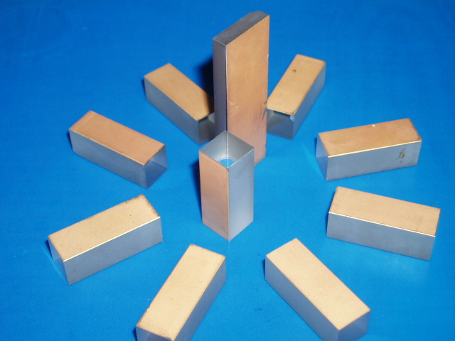

LiNbO3 Q-Switch Elements
Standard Dimension 9x9x25 or 10x10x20mm3 (other dimension is also available upon request)
Dimension ToleranceX & Y-axis: ± 0.1mm ; Z-axis: ± 0.3mm
Wavefront Distortion< l/4 @633nm
Orientation AccuracyX & Y-axis: < 10'; Z-axis: < 5'
Flatnessl/8 @632.8nm
Parallelism10"
Scratch/Dig Code10/5 per MIL-O-13830A
Chamfer< 0.5 mm at 45&ordm; ± 5&ordm;
AR-CoatingR < 0.2% @ 1064 nm
ElectrodesGold or Cr electrode on X-faces
Extinction Ratio> 400:1 @ 633 nm for f 6mm beam)
Parallelism10"

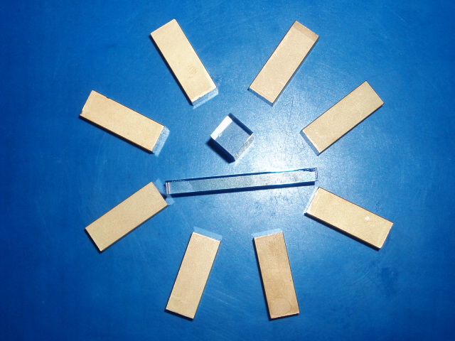

现有LN调制器:规格:
4*2.5*60mm,1.5*1.5*30mm,4*2.5*30mm,1.5*1.5*60mm调Q开关(铌酸锂),规格:9*9*25,6*6*25,16*16*35 mm
