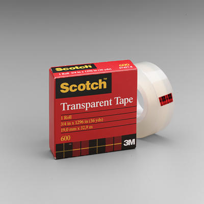

帮帮忙 现在急需用于镀膜膜层牢固度试验的3M胶带,不知道真正的型号,不知那位大侠能够提供信息。

Process: Sputtering, vapor deposition, dip plating Testing Test on environment resistance and durability: Following procedures are based on the military standard testing procedures: 1)Adhesion [U]The coating is stuck with 3M, Scotch Brand No. 600 tape ( or the similar), [/U]which will then be quickly torn off. There should be no damage on the coating. This procedure is based on (MIL-C-48497). TEL:0576-8802194
