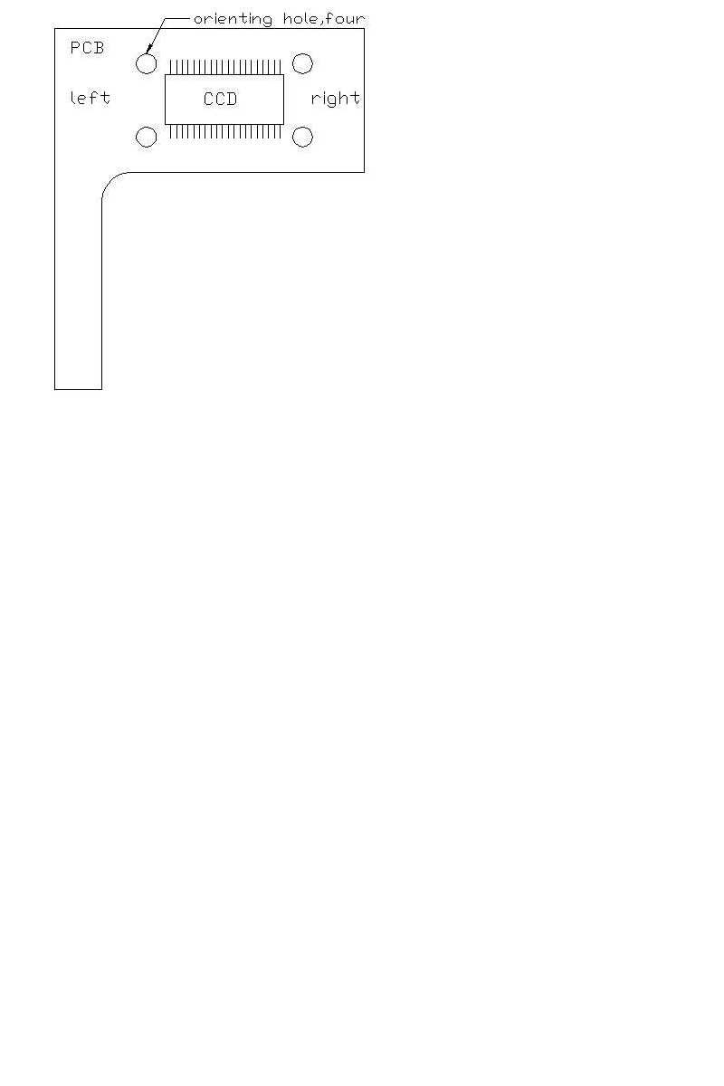

<P>四个定位孔往哪边移动较好?</P>
<img src="data/attachment/forum/dvbbs/2005-1/2005121124152202.jpg" border="0" onload="if(this.width>screen.width*0.7) {this.resized=true; this.width=screen.width*0.7; this.alt=\'Click here to open new window\nCTRL+Mouse wheel to zoom in/out\';}" onmouseover="if(this.width>screen.width*0.7) {this.resized=true; this.width=screen.width*0.7; this.style.cursor=\'hand\'; this.alt=\'Click here to open new window\nCTRL+Mouse wheel to zoom in/out\';}" onclick="if(!this.resized) {return true;} else {window.open(\'data/attachment/forum/dvbbs/2005-1/2005121124152202.jpg\');}" onmousewheel="return imgzoom(this);" alt="" />
[此贴子已经被作者于2005-1-21 12:42:06编辑过]
2005-1-21 20:41:00
往相反的方向移动试一下,如果有所改善,那么就是此原因.
至于为什么蓝色,可能有的时候也会是偏红或偏紫,与渐晕,相对亮度都是有关系的.
2005-1-25 00:04:00
作过简单的实验,没什么变化,依然存在
