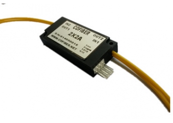

2x2A机械式光开关.jpg 名片1.jpg 产品特点<!--[if !vml]-->·波长范围宽·低信道串扰·高稳定性、高可靠性·独有专利技术、光路无胶·控制简单应用范围·光路切换·系统监测·实验室研发·动态配置分插复用
Parameter
Min
Max
Unit
OperatingTemperatureRange
-30
75
oC
Storage CaseTemperatureRange
-40
85
oC
Relative Humidity (non-condensing)
85
Parameter
Min
Typ.
Max
Unit
Wavelength window
1510, 1570 both
nm
Insertion Loss
IN1-IN2(0V)
1.4
dB
OUT2-OUT1(0V)
1.4
dB
IN1-OUT1(5V)
1.4
dB
OUT2-IN2(5V)
1.4
dB
Switching Time (90%)
5
10
ms
Switch Driving Voltage (Vcc)
4.5
6.0
V
Switch signal voltage
4.5
5.0
V
Variation in Insertion Loss overTemperatureRange
0.4
dB
Isolation
60
(accept 55)
dB
管脚定义:
# of PIN
Signal name
Descriptons
I/O
Level
Remards
1
+5.6V
0.2A
PO
2
OSU_EN
High = Normal, Low or Open :Bypass
DO
TTL
High = Normal,
Low or
Open : Bypass
3
GND
4
NC
