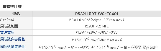

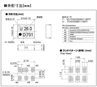

Output Frequency Range: 13~52MHz/9.2~52MHz, Standard Frequency: 16.3676/16.367667/16.368/16.369/16.8/26/38.4MHz, Supply Voltage Range: +1.68~+3.5V, Supply Voltage(Vcc): +1.8V/+2.8V/+3.0V/+3.3V, Current Consumption: +1.5mA max.(F≤26MHz)/+2.0mA max.(F>26MHz), Stand -by Current: +3.0μA max, Output Level: 0.8Vp-p min.(Clipped Sine Wave /DC-coupled), Output Load: 10kΩ//10pF, Frequency Stability Tolerance: ±1.5×10^-6max.(After 2 rflows),vs.Temperature: ±1.5×10^-6max./-30~+85℃, ±1.0×10^-6max./-40~+85℃(Option),vs.Supply Voltage:±0.2×10^-6max.(Vcc±5%),Load Variation:±0.2×10^-6max.,vs.Aging:±1.0×10^-6max./year,Star up Time: 2.0ms max, Output Enable Time: 2.0ms max, Frequency Control Control Sensitivity: ±3.0×10^-6~±5.0×10^-6/Vcont=+1.4V±1V @Vcc≥+2.6V,±3.0×10^-6~±5.0×10^-6/Vcont=+0.9V±0.6V @Vcc=+1.8V,Response Slopeositive,SSB Phase Noise:[f≤15MHz],Offset 100Hz -115dBc/Hz,Offset1kHz -135dBc/Hz,Offset 10kHz -145dBc/Hz,Offset 100Hz -145dBc/Hz,[15MHz<f≤26MHz],Offset 100Hz -110dBc/Hz,Offset 1kHz -130dBc/Hz,Offset 10kHz -140dBc/Hz,Offset 100Hz -145dBc/Hz,[f>26MHz],Offset 100Hz -105dBc/Hz,Offset 1kHz -125dBc/Hz,Offset 10kHz -135dBc/Hz,Offset 100Hz -145dBc/Hz,Temp.Sensor Output:+0.950 V Typ.(Ta=+25℃)-8.70mV/℃ Typ.,Packing Unit: 2000pcs./reel(Φ180)
