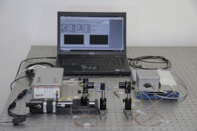

1、THz spectrometer
>  THz time-domain transmission spectrometer for 1060 nm laser excitation with free space optical path
1)The time-domain spectrometer consists of the following parts:
femtosecond fiber laser with 1060 nm wavelength
emitter antenna with THz lens PCA-40-05-10-1060-c-f
detector antenna with THz lens PCA-44-06-10-1060-c-f
delay line with 1 ns time delay
substrate holder with manual xy-movement of 50 mm
electronic components (pulse generator + lock-in detection)
Laptop with spectrometer software T3DS
The main parameters of the THz spectrometer are:
spectral range:           0.1 - 2.5 THz
spectral resolution:     2 GHz
S/N-ratio at 0.4 THz:  1000
minimum scan time:   0.5 s
THz beam diameter:   12 mm

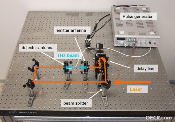

2)The time-domain spectrometer consists of the following parts:
emitter antenna with THz lens PCA-40-05-10-1060-a-l
detector antenna with THz lens PCA-44-06-10-1060-a-l
beam splitter and mirrors
THz focus distance from antennas: 50 mm
