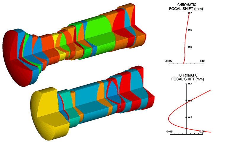

98年国际光学设计大赛的竞赛题目和色差的优化有关。根据竞赛规则,参加者可以有两种选择:只可以使用很少的面(玻璃空气接触面)和很多种不同的玻璃,或者是很少的几种玻璃和很多个玻璃空气接触面。和预期的一样,经验老道的设计者提供了top 5的结构。其中四个使用了商业光学设计软件,另外一个使用了内部专有的设计软件。尽管,其中三个人声称借助了软件的全局优化功能。但是他们的设计结果反映了他们对设计本身的掌控。从这一点来看,这一结果和过去二十年间的设计比赛是类似的。
下面的两个结构就是98年IODC的参赛答案(见下图)。上面John Isenberg的获奖答案性能极为优异,而下面不知名作者的答案看起来缺乏对复消色差的理解。图中,较高折射率的玻璃显示暖色调。
更令人感兴趣的是那些参赛答案中的失败作品。看起来,其中很多参赛者对复消色差的基本原理缺乏了解,或者是,他们试图让软件替他们思考--在这个设计案例中是行不通的。当然,镜头的复消色差并非普通工程师必须熟悉的,但是,我们讨论的是一群光学设计的专业人士。今天顶级的光学设计师消失以后,他们将接管光学设计工作。很有必要反思一下究竟发生了什么。很明显的是,光学设计软件无法提供设计结果:软件的标准内置功能是不充分的,它需要在设计者的指导下工作。

The optical design problem presented to participants in the 1998 International Optical Design Conference, involved the optimization of a system characterized by chromatic aberration. Participants had the choice of using a few surfaces but lots of different glasses, or a few glasses and lots of surfaces. As expected, experienced lens designers came up with the top five solutions. Four of the designers used commercial optical design software, one an in-house proprietary program. Although three of the designers noted that they had used the global exploration features of their software as an aid, all the solutions reflected the detailed personal involvement of the designer. In this respect, the results were comparable to those of similar contests held over the course of the past twenty years.
Two designs submitted as solutions to the lens design problem posed at the 1998 International Optical Design Meeting in Kona, HI. John Isenberg's winning design (top) achieved superb performance, but a typical solution from an unknown designer (bottom) lacked the essential apochromatic correction. In the drawings, higher index glasses are shown in warmer hues.
More interesting are some of the losing designs among the few dozen that were submitted. It is apparent that many of the designers were unaware of some of the basic principles of apochromatic correction, or else that they tried to let the software do the thinking for them—and in this case, it didn’t work. Of course, apochromatic correction of lenses is not something that you expect the average engineer to be familiar with, but we’re talking here about a group of optical design specialists. These are the people who presumably will take over optical design when today’s top lens designers vanish. It seems reasonable to ask what happened here. The obvious response is that the software didn’t provide the answer: its standard built-in capabilities were insufficient and needed to be supplemented by designer-developed workarounds.
