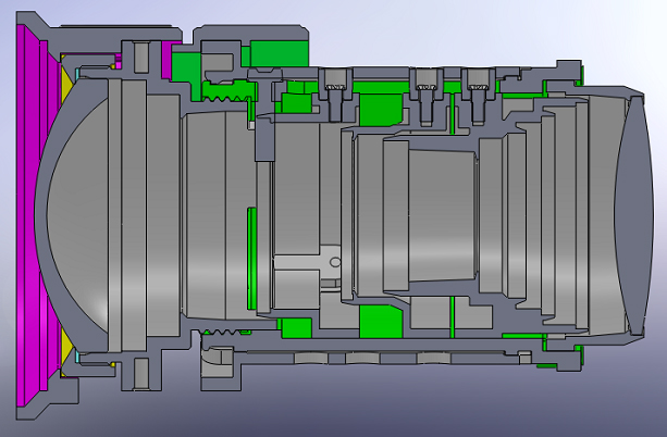

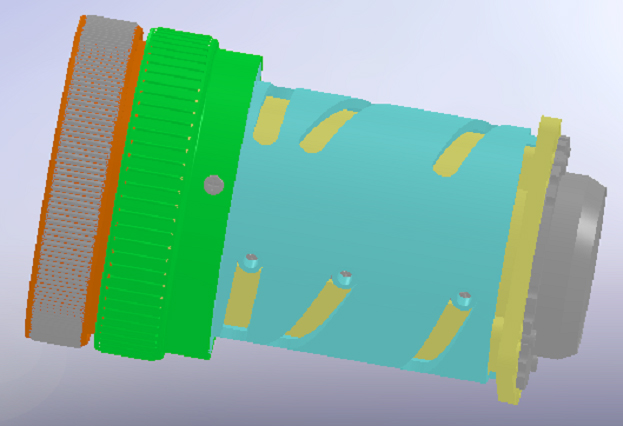

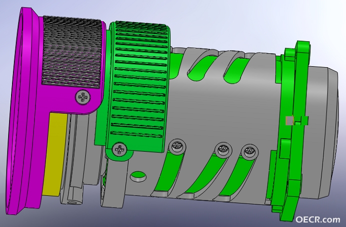

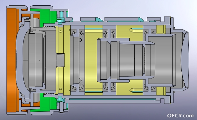

发表于 2011-5-27 11:09:23 | 显示全部楼层 |阅读模式
                                        镜头型号:SL44C
1、光学仕様                                【0.63inch (4:3) XGA Panel】                                                                光学特性
区分        項目                                                                        仕様値                                                                备注
光学仕様        "芯片尺寸
Panel size"                                                                        0.63 inch (4:3)
                                                                                縦x横 = 12.8 mm x 9.6 mm
                                                                                縦x横 = 12.5 mm x 12.5 mm
        "焦点距離
Focal length"                                                                        Wide                        19.16 mm                                        Unlimited E line.
                                                                                Tele                        23.00 mm
        "F値
F/No."                                                                        Wide                        1.7
                                                                                Tele                        1.87
        "光学部件構成
Optical specification"                                                                        10群11枚                                                                非球面1片
        "投射倍率
Projection magnification"                                                                        95.238倍                                                                60inch投写時
        "有效口径
Active image circle"                                                                        20.8 mm
        "投射范围
Projection range"                                                                        20 ~ 300 inch
        "投射距离
Projection distance"                                        Wide                                X = 0.584 ~ 9.980 m                                                                        X:投射距離 [m]
        "计算式
calculation type"                                                                        (Y =32.885 X + 0.804 )                                                                Y:投影尺寸 [inch]
        "投射距离
Projection distance"                                        Tele                                X = 0.705 ~ 10.925 m                                                                        X:投射距離 [m]
        "计算式
calculation type"                                                                        (Y =27.398 X + 0.681 )                                                                Y:投影尺寸 [inch]
        "開口効率
Aperture efficiency "                                0.9h                                        Wide                        80.72%
        "周辺光量比
Relative illumination "                                1.0h                                        Wide                        45%
                                                                                Tele                        44%
        MTF                                像高                                        0.0h                        0.32h                0.8h                1.0h        【設計値】
        (60inch)                                                                                                                                        弧矢方向/子午方向
        (Wide)
                                        45 lp/mm                                R        78%                        68%                55%                40%        R (650:625:595=1:2:1)
                                                                        G        80%                        75%                80%                68%        G (569:536:503=1:2:1)
                                                                        B        45%                        45%                30%                28%        B (495:460:435=1:2:1)
        倍率色差Chromatic aberration of magnification        R/G                        A                                        X                0.0μm                  Y                5.5μm                  R (650:625:595=1:2:1)
                                        B                                                        -6.81μm                                  5.4μm                  G (569:536:503=1:2:1)
                                        C                                                        0.0μm                                    0.0μm                  B (495:460:435=1:2:1)
                                        D                                                        0.0μm                                  -4.0μm
                                        E                                                        -5.1μm                                 -2.6μm
                B/G                        A                                                        0.0μm                                  0.0μm
                                        B                                                        -1.2μm                                 -0.3μm
                                        C                                                        0.0μm                                     0.0μm
                                        D                                                        0.0μm                                  -2.9μm
                                        E                                                        -3.5μm                                  -4.7μm
2、 構造仕様                                        投影镜头结构 / Projection lens: Construction
构造仕样        "投影角度
Angle of  Projection"                                                                        Wide                        10°
                                                                                Tele                        8.4°
        "投影率
Zoom ratio"                                                                        Wide                        1.48
                                                                                Tele                        1.78
        "透过率
Transmittance"                450nm                                                        86.30%                                                                "最低値
min. value"
                        550nm                                                        88.90%
                        620nm                                                        88.90%
        "透镜全长
Lens length"                                                                        78.75 mm
        "焦距
Focal length"                                                        R                9.225 AIR + 26 BK7                                                                BK7(n=1.51872)
                                                                G                9.200 AIR + 26 BK7                                                                BK7(n=1.51873)
                                                                B                9.415 AIR + 26 BK7                                                                BK7(n=1.51874)
        "镜头全長
Total length"                                                                        115.2 mm
        "最大鏡筒外径
Maximum optical column on outer diameter"                                                                        Φ51.2 mm
        "后焦距
Back focus"                                                R                        18.025 Air + 26 BK7
                                                        G                        18.000 Air + 26 BK7
                                                        B                        18.215 Air + 26 BK7
        Focus 调节轮                        "回転方向
Direction of rotation"                                                "屏对向镜头:顺时针为缩短
Screen to lens: CW near."
                                "回転角
Angle of rotation"                                                60°
        Zoom调节轮                        "回転方向
Direction of rotation"                                                "屏对向镜头:顺时针为放大
Screen to lens: CW wide."
                                "回転角
                                镜头型号:SL59S        [/b]
1、光学仕様                【0.79inch XGA Panel】                        光学特性/ Optical specification
№        項目        仕様値                                        备注
1        芯片尺寸        0.63inch XGA (12.5μm)                                        0.62992inch (1024*768)
        Panel size
2        投射倍率        111.11倍                                        Wide 70inch 2.07m
        Projection magnification        111.11 times
3        焦点距離        18.82mm (wide)                                        Unlimited E line.
        Focal length        22.60mm (tele)
4        F値        F2.3 (Wide)/   F2.5 (Tele)                                        Unlimited E line.
        F/No.
5        投射範囲        30” ~ 300”
        Projection range
6        投射距離        WIDE        X=0.576~8.943m                                X= 投射距離(m)
        (計算式)                (Y=33.465X + 0.72)                                Y= 投射尺寸 (inch)
        Projection distance        TELE        X=0.695~10.737m                                X= 投射距離(m)
        (calculation type)                (Y=27.882X + 0.615)                                Y= 投射尺寸 (inch)
7        有效口径        φ21.6mm                                        Ymax=10.8mm
        Active image circle
8        后焦距        34.764mm  (9.052 Air + 25.712 BSC7)                                        BSC7  nd = 1.516798
        Back focus
9        透镜全长        90.74mm
        Lens length
10        MTF 50lp/mm                        R        G        B        R:620 G:550 B:460
                WIDE                65%        67%        53%
                TELE                60%        67%        49%
11        周辺光量比        43% (wide)
        Relative illumination         42% (tele)
12        開口効率 0.9h        80%(wide)
        Aperture efficiency 0.9 h
13        透過率        87.9%  (450nm)                                        積み上げ計算値(最低値)
        Transmittance        91.5%  (550nm)                                        Stockpile calculation (min. value)
                91.3%  (650nm)
14        倍率色収差        R/G  5.6μm 、 B/G 2.5μm                                        620nm:550nm:460nm
1        后焦距长                        18.568 Air + 25.712 BK7
        Flange back
2        镜头全長                        130.7
        Total length
3        最大外径                        φ58mm
        Maximum optical column on outer diameter.
4        重量                        127g
        Wait
5        回転方向        Focus 调节轮                屏对向镜头:顺时针为缩短
        Direction                        Screen to lens: CW near.
        of rotation        Zoom调节轮                屏对向镜头:顺时针为放大
6        回転角        Focus 调节轮                60°
        Angle of rotation        Zoom调节轮                60°
SL44C
SL44C
SL44C
SL44C
SL59S
SL59S
SL59S
SL59S
