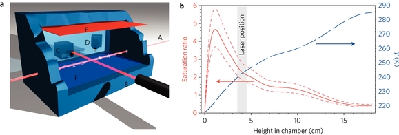

To test the rainmaking idea, the researchers used a laboratory cloud chamber and fired short pulses of infrared laser light into the chamber in conditions of low temperature and very high (230%) humidity. A second low-powered laser was used to illuminate the chamber and allow them to observe what was happening, and measure any water droplets produced.
They discovered that after the laser was fired 50 μm droplets formed immediately along the plasma channel, forming a miniature linear cloud, and the drops then coalesced to form larger droplets around 80 μm in diameter during the three seconds after firing. The total volume of condensed water in the chamber was increased by 50% and the cloud could be seen with the naked eye.

a, Experimental set-up (schematic). b, Measured vertical temperature (blue, right scale) and derived supersaturation profile (red, left scale) in the chamber. Image credit: Nature Photonics, doi:10.1038/nphoton.2010.115
